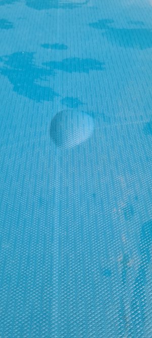

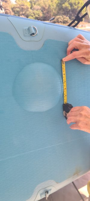

The same happened to ours,
I usually pump up up to 1.1,
the manufacturer was not interested in helping. Very disappointed.
