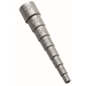

Once it's soft bang a conical plug in to stretch it (I hope you can get it out again).
