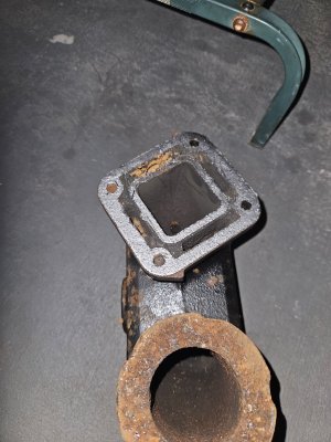

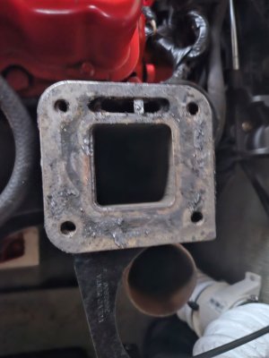

I have an exhaust riser extension - manifold + riser extension + elbow. Both the extension and elbow have four slots for the water circulation, however there is a restrictor plate on top of the extension, that is, between the extension and elbow.
All slots with fair bit of residue & clogging. Based on previous owner's service receipts, manifold and riser were replaced 3 years ago.
The position of the slot on the restrictor plate is on the side closest to the engine.
Well you definitely have some kind if restriction in the exhaust. I would clean all the passages and check that the water entering the exhaust bend can actually escape out of the other end. Then refit with new gaskets.

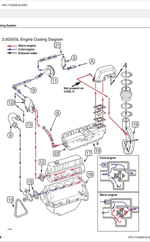

A cooling system diagram I came across seems to indicate this J hose should be cool, if I read the below diagram correctly. Should this be the case, what are the possible issues causing this J hose to be hot (and pressurized) that might not be a cooling water flow restriction? Head gasket issues?
Thank you.
I think the reason the J hose gets warm is because the water isn’t flowing as it should. You say the hose isn’t pressurised if you disconnect the hose to the manifold which confirms the restriction is downstream of this. Have you checked that the elbow fitting where the hose connects to the manifold is clear, are the exit holes in the exhaust bend clear as these tend to rust and restrict the exit flow.
These GM motors are very under stressed and are solid cast iron and seldom have head gasket problems, but to be sure you could fit a clear hose between the thermostat housing and manifold and look to see if there are any air bubbles in the water when the engine is warm.
Does the manifold or exhaust bend get hot? you should be able to place your hand on them without it burning which indicates a good through flow of water. If there is a restriction the water stays in the engine too long increasing the temp.
