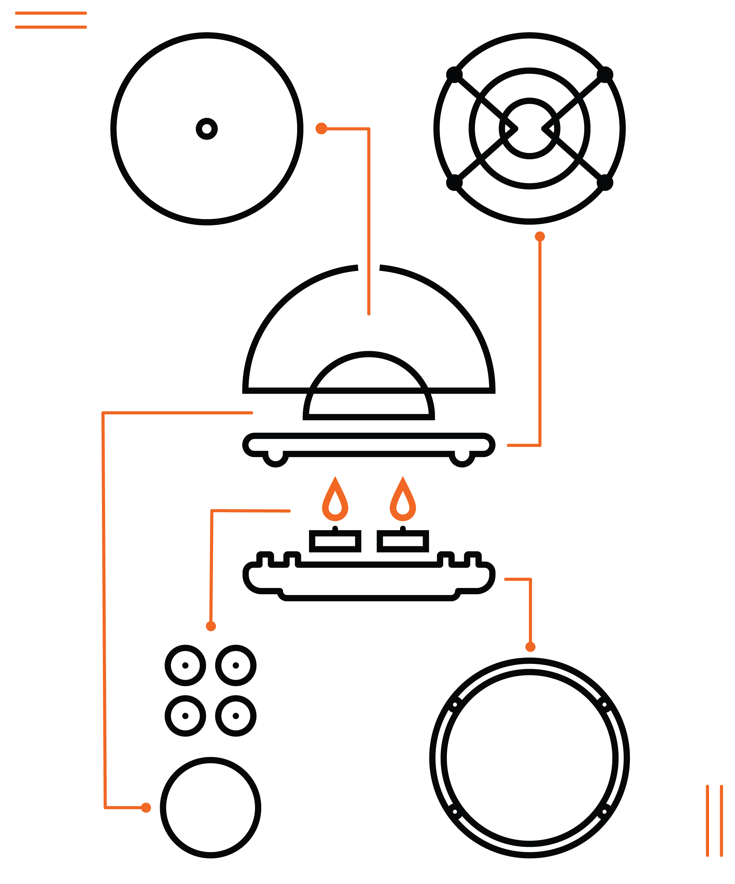

https://images.indiegogo.com/file_attachments/1073955/files/20141205095217-pezzi.png?1417801937
https://images.indiegogo.com/file_attachments/1073578/files/20141205071840-032.jpg?1417792720
