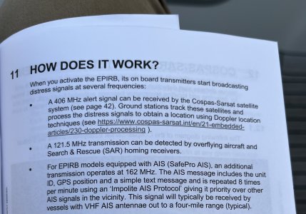

I’ve had the McMurdo equivalent (G8) aboard for the past couple of seasons. No MMSI input into that. Bullet 3 explains what the AIS frequency transmission of the EPIRB contains:
Seems to be a generic sentence, so far as the boat is concerned; BUT with the EPIRB unit number as the specific identifier….Meaning no user input of an MMSI required. On a McMurdo.

Just had another look and yes it’s not in there. I really expected this thread to be a “read the fine manual” kind of affair. Thanks again, I’m happy to assume the McMurdo manual explains it nicely and will give it a test when we get back to the boat with apologies to those in the Solent for yet another test alarm 🤣
