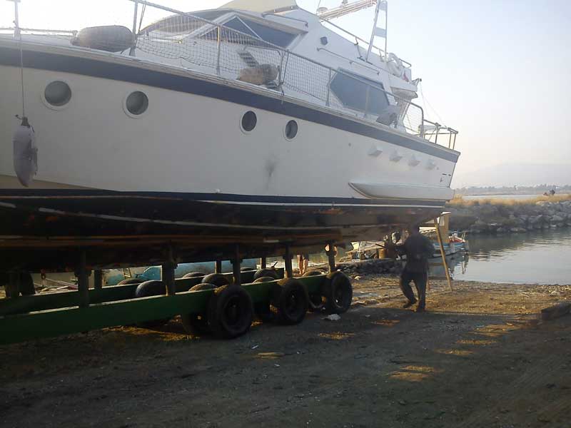

I think we got out of track on this one and I have to apologise at it's my fault. I'll try to clarify.
as you can see in the pic above, there is an intake on each side high up on the gunwale level (I just measured it, it's 90X700mm)
There are 4 scoops or whatever you call them further aft almost level to the ceiling of the e/r, for extracting the hot air.
It's the intakes I'm slightly worried that maybe lots of seawater spray comes in underway on rough seas as there's a fair amount of spray all over tbh.
Futher since this intake is more or less channeling the air straight to the port engine air intake I was wondering if that can be causing problems. I know of another smaller sportsboat 33ft or so that had similar issues that were solved by simply fitting a deflector that led the fresh air further aft on entry.
Not checked for a baffle as yet, will report what I find tomorrow.
Regarding the outlets, a clear observation is that they are definitely MUCH smaller than the intakes! (talking sqcm area)

Looking at the detail (stolen from one of your other posts);
Water will have to flow upwards and inwards to get through ... and what hits the baffle above and goes in,will run off the next one downwards etc., so suspect that not too much water will get in there. The water that may get in, should get trapped by some sort of drainage in the ER well before it gets near the engine's air intake. If you look at your picture, the intake in question is very near the front of the ER (Behind of Galley ... guess aligned with cooker and helm position from what I can see), as it is just above rear porthole of side cabin, whish stretches a bit behind that porthole from recollection.
That means that water have to;
1) Get in through the grid above
2) In to the front of ER
3) Travel about 2 - 3 Foot backwards to air intake whilst only dropping a short foot from ER Top level.
You may take in some water here, bus suspect your time (and money) is better spent on other work, and installing proper exhaust system as per LS advise...
