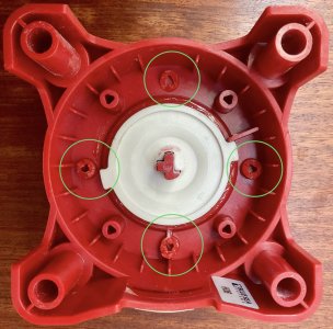

In my case it seemed almost like the contacts had broken loose inside the switch's plastic housing. For a while closing it firmly would get a good connection and then it deteriorated. The good thing about those switches is that testing is easy - you can hotwire past them using a screwdriver and the exposed lugs on the back.
Certainly don’t rule out the main battery switch as the cause of the problem.
I have five failed Blue Sea battery switches to show that not all battery switches are reliable. The issue is a common fault with these particular switches. Unfortunately, Blue Sea does not seem interested in providing replacements.
