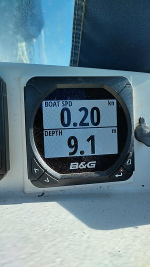

Funny thing is, it's dissapeared from the NMEA 2K network.
Even more odd, it's one of those combined log/echosounder transducers and the log still shows up on the network.
Bit a loss really.
Bit a loss really.
I have no experience with the electromagnetic log transducers and antifoul, and have never seen one combined with a sounder, my sounders have all been separate. Had I known there was an electromagnetic log sensor involved too I wouldn’t have posted. The sounder part of the transducer will be ok with the AF, others will have useful knowledge about the log and AF.
I still wouldn’t expect the sounder to have any meaningful readout through air, but I would assume it should be present on the N2k, unless the system is clever enough to not display data it assumes to be unreliable or wrong
I still wouldn’t expect the sounder to have any meaningful readout through air, but I would expect it to show on the N2k system, unless the system is clever enough to not display data it assumes to be unreliable or wrong
Just a question .... Where does OP say what type of sounder it is ??

I saw that ... but I would class my Echopilot Duo as combined ... as its dual display ... but transducers are separate.
I’m not aware of a combined log/sounder transducer, just reading the post literally. It does make more sense if the transducers are separate, especially as the depth transducer part isn’t showing on the N2k
