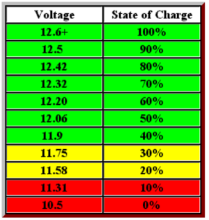

The subject can be a bit complex when factoring battery types, chemistry, ambient temperature etc. in, but as a basic rule:
Start batteries will suffer if discharge more than 80% (some dual consumption/start types tolerate 50%, dedicated deep cycle consumption batteries much lower).
Hence the theoretical lifetime of starter and dedicated deep cycle batteries are.
