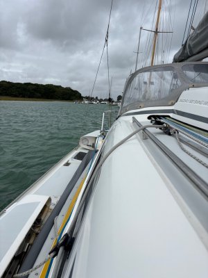

I recently passed a moored Dragonfly tri and noticed the shrouds are secured to chainplates on the outriggers. When the outriggers fold in or out, the entire chainplate (obviously) moves with the outrigger. I assume the arc is such that the tension remains similar throughout the move. Once the outriggers are in their folded or sailing position, block-and-tackle allow for fine tuning.
Have I got all this right?
Does it work well?
Do people typically measure the shroud tension/mast angle before sailing or just pull it a bit and see if it looks ok?
