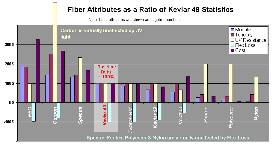

Be careful though, its active ingredient 'Vectran' actually has very poor UV resistance and breaks down very quickly in strong UV. So if you are thinking of Serious Blue Water cruising and expect the sails to be flying for long periods of time, maybe not the best choice of material.
This very useful chart compares the stability and tenacity of various fibers used in sails...
source: http://en.wikipedia.org/wiki/Sailcloth
