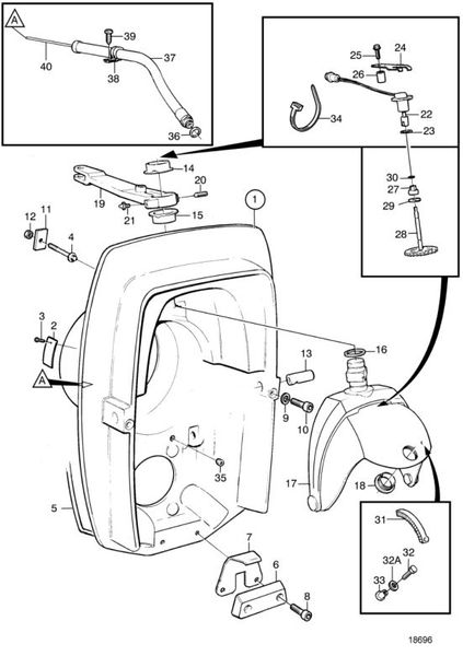

4 May 2018 #1 simonfraser Well-Known Member Joined 13 Mar 2004 Messages 7,613 Location Outboards 4 mobo’s, unless you do a lot of miles Visit site does this just pull out when the helmet is out of the way ? or does it require internal access ?
4 May 2018 #2 2 [2068] ... Joined 19 Sep 2002 Messages 18,113 Visit site Not sure which "spindle" you're referring to? The trim sender wheel, part 28? If I remember rightly that just pulls downwards. . Last edited: 4 May 2018
4 May 2018 #3 simonfraser Well-Known Member Joined 13 Mar 2004 Messages 7,613 Location Outboards 4 mobo’s, unless you do a lot of miles Visit site yep that's the one, tnx. the bellows are being done shortly and the internal access is a 'challenge' i will have the item 28 ready.
4 May 2018 #4 2 [2068] ... Joined 19 Sep 2002 Messages 18,113 Visit site Make sure the wheel and the rack are aligned properly when you put it back. A couple of teeth out = incorrect trim reading. Way out = unhappy sound of small plastic parts breaking.
4 May 2018 #5 simonfraser Well-Known Member Joined 13 Mar 2004 Messages 7,613 Location Outboards 4 mobo’s, unless you do a lot of miles Visit site indeed the mechanic will get the wheel to insert when he does the bellows. i will set up the rack.
