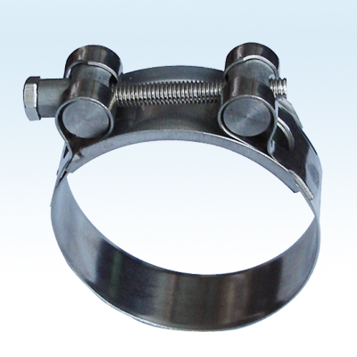

I'd rather blame VP for not using proper heavy duty clips like the one below - not that they are alone in this, mind.
Cummins use a constant torque hose clamp, has a heap of belville washers under the screw so although you can overtighten them, it's a lot easier to set them right and not damage the hose..
Well, you live and learn, as the old saying goes.
What I just learned from someone who knows much better than myself is that nut and bolt clamps aren't necessarily better, because their design inherently creates a tension which is akin to closing the top of a "U", as opposed to the more evenly distributed band tension of jubilee clips.

But it's rather a matter of how well designed and built jubilee clips are, than of replacing them with nuts and bolts type.
