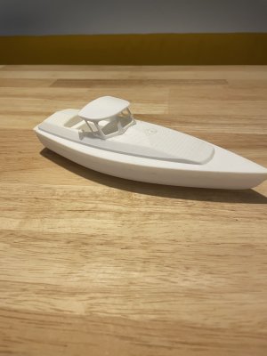

Spent more time than I care to admit making a cm accurate 3d model in Autodesk CAD of my boat. Now at the stage of trying out various iterations of the doghouse design and 3d printing them off to check for aesthetics.
Been quite fun so far.

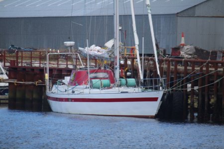

This is Novak's earlier Pelagic, the dog house is built for serious weather in Southern Ocean waters, pictured in the Falkland Islands.

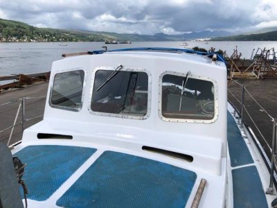

This is my mates boat.
gary

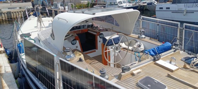

Did you mould the hardtop yourself?
We didn't do it with a mould. Its foam core composite construction but it was laid up in panels over the original frame in a stitch and glue type approach. The core was then bonded inside. We then turned it over, once it was rigid enough, and laminated it fully. It was a lot of work but we are very please with the outcome.
Yes, lots of solar. 1300w. No gas on the boat. Electric galley with combination oven and induction hob. Everything runs from 14kw of lithium batteries.
We haven't plugged in at a marina or run the generator since we launched in July. The boat is so much cooler in the Tropics without gas

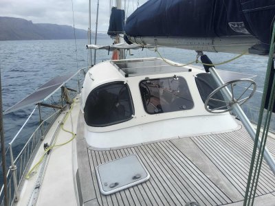

I don't describe my hardtop as a dog house as its a perfect replica of the previous sprayhood. It was actually patterned from the old sprayhood. The window openings are also the exact size. The big benefits for us over the old sprayhood is the sun protection and the reduced temperature underneath it.
The old navy blue sprayhood was brutally hot in the tropics. So hot that going to weather with some spray flying, you either sat outside and got wet or sat under the sprayhood and cooked.
We can now sit under the hardtop and its cool. The windows are perspex and tinted, which helps but we have phiffertex covering the curved windows to keep the sun off. They work really well but still allow good vision outwards.
The foam core gives lots of insulation and the white finish helps reflect heat. We can also enclose the rear completely with our 'Alaskan flap' as it now know😄
I didn't think we would use it in the Tropics, but at night when it's raining with a following breeze, it simply zips on and keeps you dry. Night sailing in shorts, T shirt and slippers is a reality!
