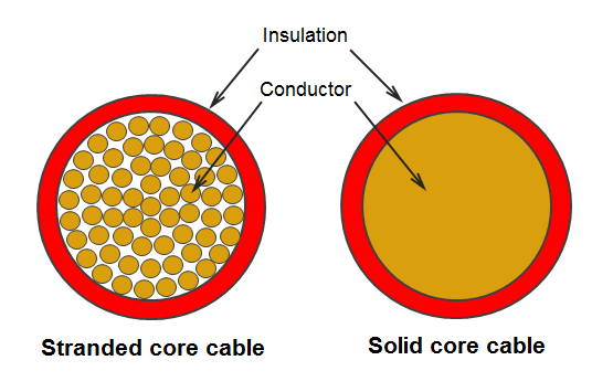

Your calculation is for a solid conductor. Multistrand flexible cable is less densely packed and has air voids inside it, so the apparent conductor diameter would be greater than 6.6mm.
