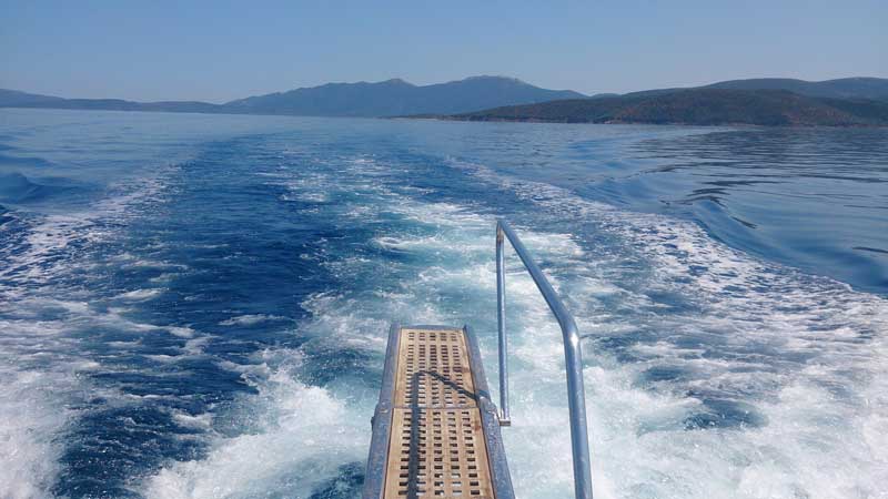

just did my calculations following last weeks 3day excursion to a couple of nearby islands.
that is 75nm
all done between 7 and 8knots
Boat has a planning hull and waterline length was accurately measured to 10.60m at waterline (13m overall)
D speed according to the 1.34Xsqrt(WL length in feet) gives 7.9knots
Finally remember we have no tides down here so speed is speed (bar going with or against the wind/waves et al)
Consumption was approx 3lt / nm for 12K kilos
Is this about right?
Now, I've read the theory with the bow wave and all that, but call me thick, I cannot (being on the boat) figure out if I'm at the right speed or a bit above it.
I'm asking as i'd expect a bit lower consumption and I'd also expect a much smoother exit of the water on the stern which looks like some very messy water popping about and reaching regularly the swim platform a good 25=30cm above the water (and 1.2m behind the stern).
I pic of the water at the stern follows, got a few video clips from mid boat on either side but they are too big (and useless imho) to bother and upload them, will probably try again from the dingy next time.
cheers
V.
Vas, there is calculated displacement speed,
but there is also the shape of the hull,
your boat (like mine) has a planing hull, and therefor is less optmised for displacement speed than a real D boat
the blunt stern fe,
but I look at it this way, the less wash / wave movement you generate, the closer you are at "your" displacement speed,
if you really want the lowest fuel consumption, move the boat with as little wash as possible.
every movement of water / waves consumes energy / fuel,
a few years back, on my way from SOF to Rome I have been testing during hours at one speed, 8, 9 , 10, 11 and 12 kn
and try to establish fuel consumption.
The answer is very simple, fuel consumption goes up gradually with speed,
there is not something as a optimum speed, choose your own optimum.
I like 10kn for my boat, that gives foam behind the boat just like on your pic,
fuel cons about 7..7,5l /nm
and is faster than many real D and sailing boats ;-)
we are in Venice right now, trip of 400nm, mostly at 10kn, 43hrs, 7l/nm average
I also cruise a lot at around 8 kts, this gives me 4.2l/NM. Boat is 48' SD hull, 25t with 2x3208TA CATs. A friend with the same hull (he has a Trader, mine is a Kha Shing) and CAT 3126 engines achieves 2.75l/NM. Such a big difference, only because of the engines...

Thanks Bart, makes sense, will try again but atm I have my son and his gang as autopilot and I really need to finish the garmin a/p installation soon (or the hard top else I'm going to cook these guys and gals...)
Hardmy, that's slightly confusing, your engines are around 400hp each and the others are smaller, similar or what?
TBH, I'd expect similar fuel consumption on a similar hull carrying similar load and same length especially at those speeds that AFAIK prop demands should be similar. Care to elaborate?
Vas what would your engines consume per hour at idle and neutral. No load? I ask because I seem to recall reading some where my KAD42s would consume 6 l per hour. i.e. The difference may then be smaller than you think looking at total consumption if that makes sence
Bruce, that's an interesting POV, IIRC MiToS does around 4kn with both engines engaged and idle (around 650rpm) The 8kn I'm travelling is around 1300rpm. I know things are not really linear but at 8kn means both engines drink 8X3lpkn = 24lt or 12lt each at 1300rpm which is not really much. Makes me feel slightly better, although I'll try 7kn on a night passage and see what I get.
