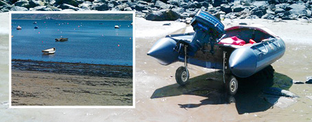

Personally I do not like the sand hopper type, flat firm and small stone (chain) can cause problem. I would go pneumatic also I would probably pay 100 odd pounds for something like these.
http://www.polymarine.com/archives/477
http://www.securefixdirect.com/launching-wheels-for-boat-folding-type---dinghy--marine--rib--stainless-steel-3870-p.asp
I have used similar in the past and they are good. It set right and approaching slip I used to drop them down with engine down. Wheels would touch before engine :D.
Protected outboard as well, could do same for launching... No trolley to mess with protection for outboard, well worth considering.

Best bet for me is the kayak trolley for £54 (top picture)
http://www.cornwall-canoes.co.uk/equipment/canoe-trolleys.htm
I had one on my kayak that just pulls out, doesn't float the kayak nor will it the tender, adjusts and packs up small, big enough wheels for rough ground etc. 4 U Bolts for the uprights to slot into and job done as the transom will fit on the angle part!
