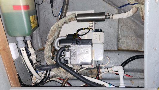

21 Jan 2025 #1 B brunobarbosamg New Member Joined 21 Jan 2025 Messages 2 Visit site Hello all! I have a heater diesel aboard, a Webasto Thermal Top C, that is making a weird noise like willing to start but doesn't. Here is the video: Any ideas? I don't know where to start. and here is an image:
22 Jan 2025 #2 P4Paul Well-Known Member Joined 25 Nov 2007 Messages 1,312 Location Body in Hampshire. Heart in Cornwall Visit site https://www.dieselheaters4u.co.uk/uploads/7/7/1/3/77137867/907512b.pdf Page 602 describes how to reset the burner lockout after three unsuccessful ignition attempts I couldn't hear the click/clack of the fuel pump in your video, worth locating and making sure it is working before trying the lockout reset.
