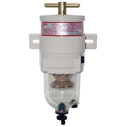

You might find a Racor 120AT is suitable - spin-on filter element makes it easy to change. £73 here - https://www.hyphose.co.uk/120at-448 - but rather more at ASAP.
Thanks pvb, 10 micron should be fine enough?
I just had a look at this one https://www.hyphose.co.uk/racor--filtration/racor--filters/500fg10-469, bit more expensive , £140.00, but probably easier to replace the filter?
Someone on here has previously recommended a Chinese version of the 500FG which I think are about half the price and take the same filters.
I have a 500FG on each 30bhp engine and use 10 micron filters and have always been very pleased with them.
Richard
Did any one buy Racor Type Diesel Filter Water Separator Fuel chinese version from eBay, only £39.99, but is it worth of risk ?!? Or they are very similar quality?
Might have been me. I did as this forumite did [ http://www.ybw.com/forums/showthread.php?463929-Facor-fuel-filter-recommendation-(fake-Racor-500FG) ] and am very happy with the result for ~£60 or £70. Do follow his advice to smooth off rough edges, replace the O rings and replace the lousy, ill-fitting filter that comes with it with a proper Parker Racor one (2010TM; eBay will oblige). 10 micron is arguably a bit fine, but the filter has such a large surface area for the fuel consumption of my 40hp Yanmar that it’s fine and the fine gauge gives you comfort that small particles aren’t getting through. I seem to recall I had to change the hose tails, I think from 10mm to 8mm: ASAP supplies or some such will oblige.
The ease of filter changing, and the centrifugal water separator, and the ability to see any crud that’s collected, made it a rewarding change.
BTW, the priming instructions are here: http://www.parker.com/Literature/Rac...ine_Series.pdf and here's a great article on how the things actually work: http://www.racornews.com/single-post...s-Fuel-Filters
No, they're absolutely not; but (as per my post above) if you sand the rim, bin and replace the O rings, and bin the filter and only use Racor ones, IMHO they're fine and I have done one or two thousand miles on mine without problem, with big saving and with visibility of any water or bug in my diesel.
