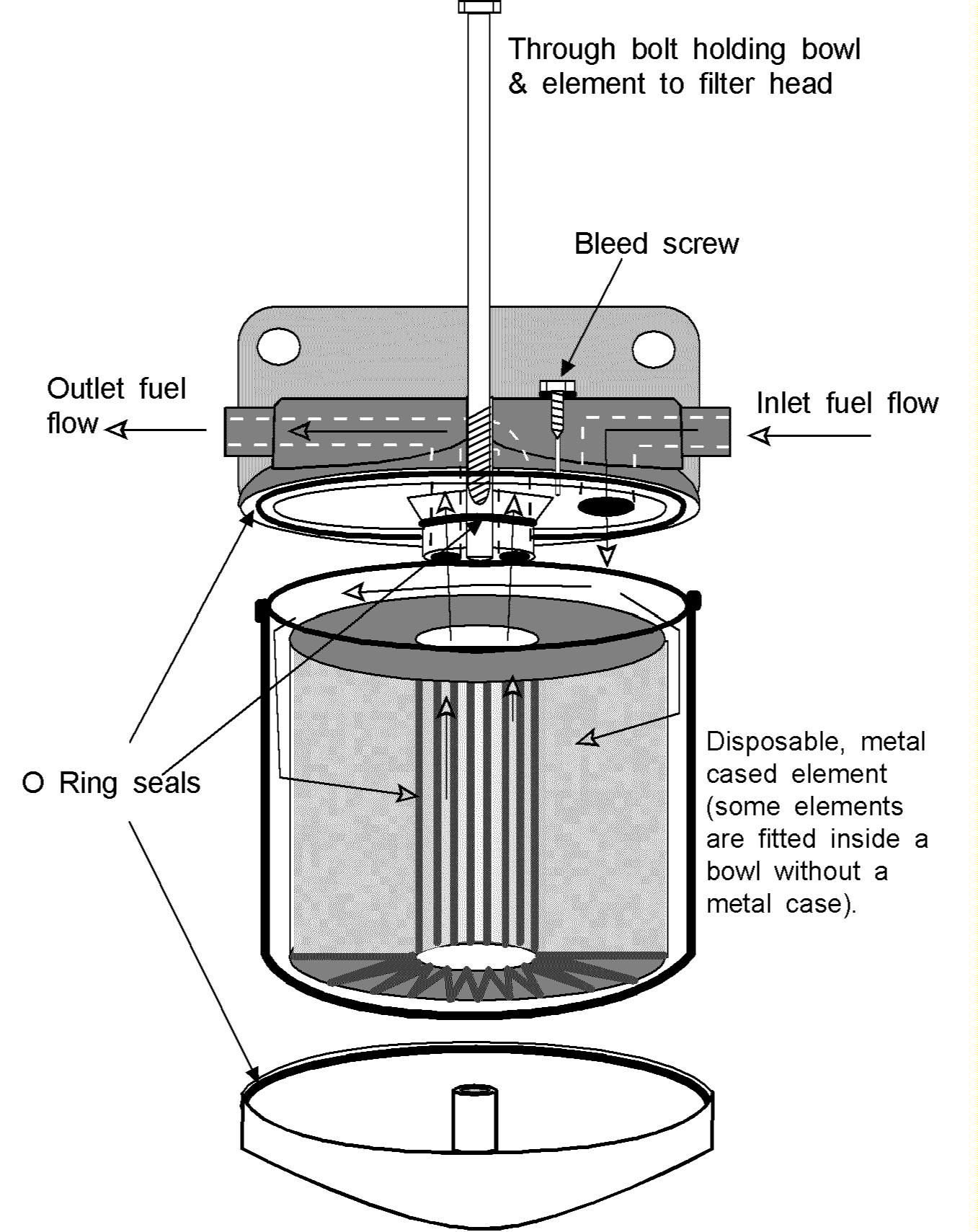

My boat's out of the water at the moment - going back in next Friday. Engine is a Yanmar 1gm10 and there is water in the diesel. Tank has about 20 litres left so I'm going to drain from the bottom and chuck it. The tank feeds from slightly above the bottom to a glass bowl water trap which is below the tank outlet and it's a pita to drain and make sure it's sealed. I'm going to get rid of it and replace with a CAV filter and water trap combined. I would like to mount this on the bulkhead behind the engine but it would be about 10 cm above tank outlet.
Question is: would this be OK? It would be really easy to drain if placed here.
