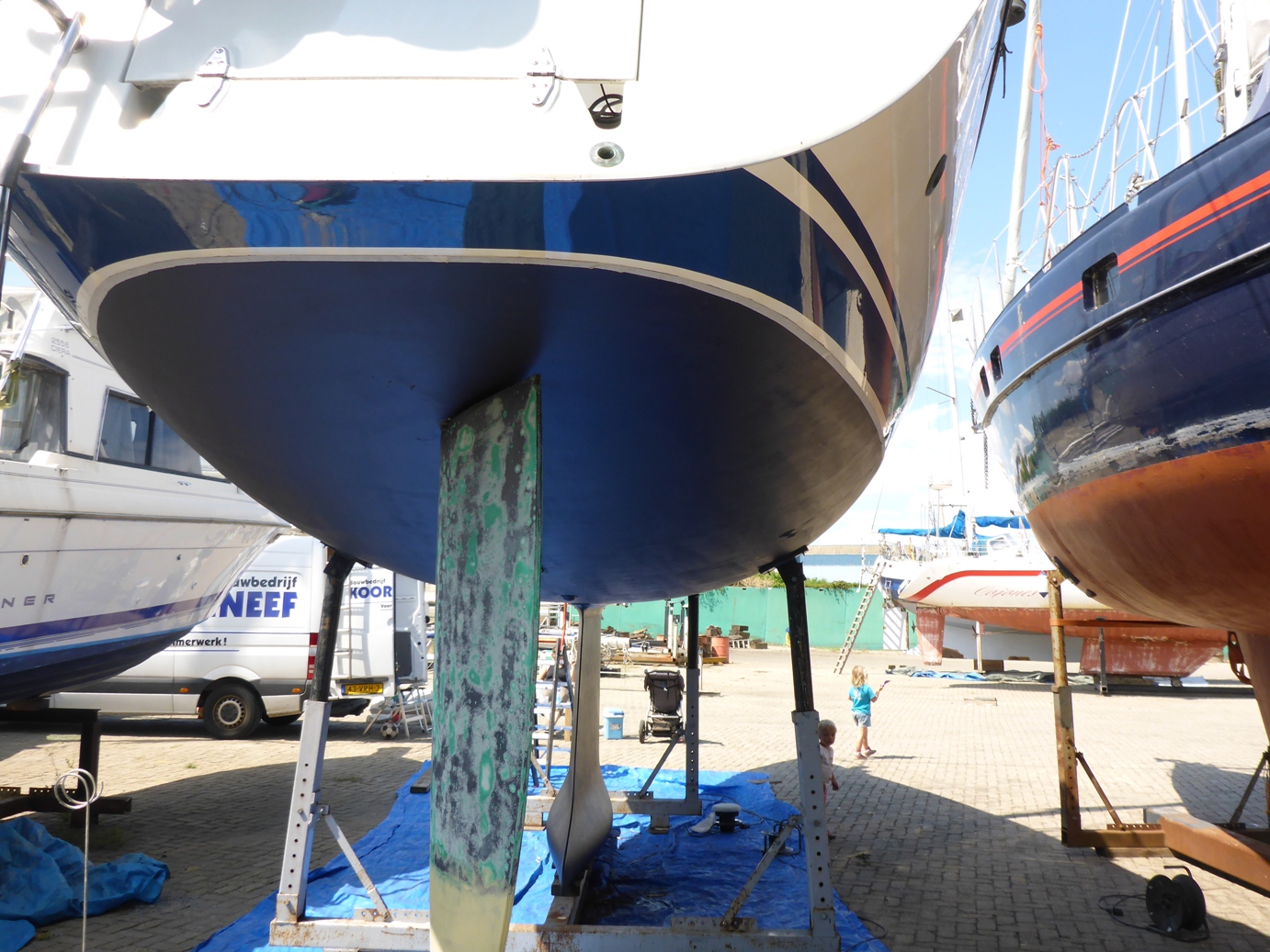

SWMBO and I are seriously considering one of these boats to replace our Sadler 29 after 15 very happy years. We like the layout below and the somewhat quirky cockpit and sail control arrangements. My nagging doubts mainly concern the very different hull, keel, and rudder configuration. Apart from the lack of space the only thing I don't like about the Sadler is the way that the windward bilge keel breaks the surface and slams when hard pressed to windward. So will the Dehler slam? And just how lively and/or difficult to control will she be in stronger winds?
The hull shape looks reasonable to my untrained eye, she is generously ballasted, and Van de Stadt are reputed to know what they are doing. Anybody know these boats?
If we can find one we would prefer the shallower draft wing-keeled version.

Check the rudder carefully. I have seen several with cracks emanating from the area where the rudder stock enters the blade. I believe the stock itself is aluminium and can corrode a bit. They are quick boats though!
The rudder stock is most likely from Jeffa, they make rudder stocks for just about everything.
Cutter who used to frequent the forum used to have one IIRC. The hull looks a very similar underwater profile to our Etap 35i.
