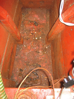

Well spend last weekend doing all the prep work. Tube made, drift made. I poured 4 litres of cheap Tesco cola in the bilge - hope non-proprietory brand is OK? The only thing I did not do is heat the bolt up. The reason for this is that on the top it seems to be surrounded by black tar varnish and underneath, it is embedded in the deadwood; and I dont really want to set the whole boat alight. How does one heat the thing then?
PS. Chipped away underneath to get the pug looking clearish; shall I chisel in around the plug?
Here are a couple of pictures of the bolts top and bottom. (yeh - I know I need to replace frames there too, but I was going to wait after my attempts with the sledge hammer). The top bolt has hardly anything showing as it is swimming in tar around it. Was wandering wehther I shoudl chisel down and eventually grave a new bit of wood afterwards - that would allow me more to bash it down.
The bottom bolt shows that it is well encrusted - and I am unsure whether I should chisel away around it or not.
