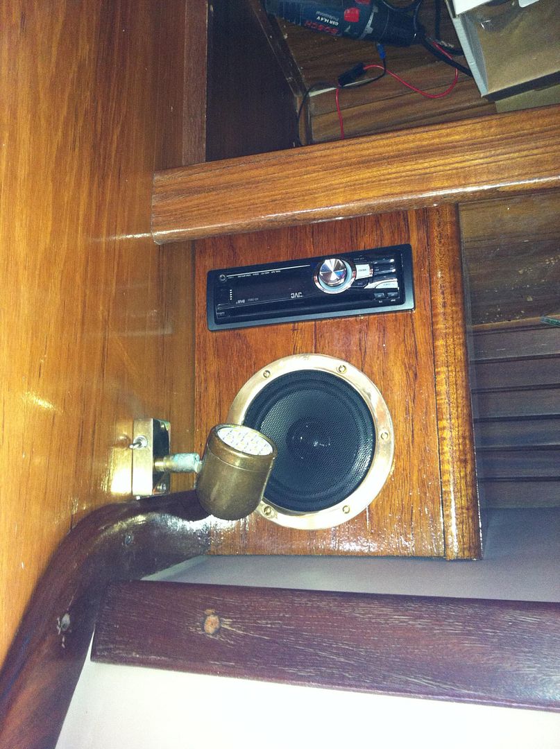

I'm based in Norway - but we have the same scenario here DAB already implemented and FM going to be phased out in some years.
Installed a car radio with FM/DAB+/CD/Front AUX - standard car radio size.
Works fine both with DAB and FM reception.
The DAB aerial that came with the radio is not the best for boat use, so I'm looking for a better solution (It's for gluing inside the window).

We had a nice portable DAB/FM radio that could charge from 12v, worked great apart from one small issue.
When the antenna length got reduced due to some accidents it didn't receive that well anymore..
So I installed this with speakers in the cabin and cockpit
Link to larger pic: http://i372.photobucket.com/albums/oo167/knuterikt/Stereo/th_IMG_1063_zps20103b7e.jpg
Ugly :) depends on the eyes viewer?
