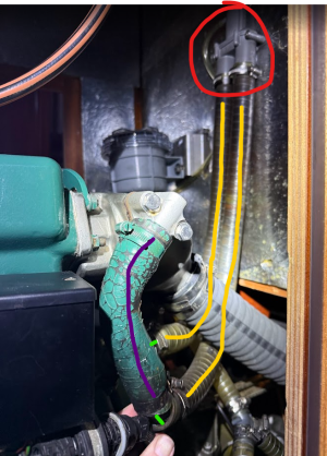

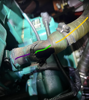

Its the hoses at the back of the engine that I am worried about and would like to replace. We have this Vetus antisiphon valve circled below in red between the heat exchanger and the exhaust elbow. Note the two yellow marked hoses, one going to the exhaust elbow, one to the heat exchanger. This is where things get a little odd (perhaps? maybe this is normal?). These hoses go to a connecting piece of copper (?) pipe (marked in green below), where these are clamped on with (single!) hose clips, that connects on to the original VP hose (marked in purple).
The one that comes from the heat exchanger is probably the most alarming, as the cut on the pipe looks particularly iffy.
What should I replace these with? Two, single hoses, without the strange copper pipe affair, would seem the sensible option? It wouldn't need to be an expensive moulded VP one either?
