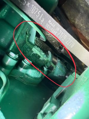

I've been vexed by a very small leak of coolant, that after long chugs, has required me to top up the header tank on the engine. Looking under the engine, that I keep completely and meticulously clean, I could see no trace of coolant.
Doing my post passage engine checks on arriving to Belgium after a long chugs, I noticed a tiny green splodge under the circulation pump. Poking my head under the pump, I could see, just like the raw water pump, there is a weep hole to tell you when the pump seals need to be replaced. This had clearly been evaporating before dripping for the most part.
Can you rebuild these like I did with our raw water pump here (https://forums.ybw.com/threads/vp-d2-55-raw-water-pump-refurb-or-replace.601222/)? Or best to replace with one of these https://parts4engines.com/products/...rN9Yy9lyiWypSHMNFdaVO2wwhHCbwTH8htUSw-hI-1H6? It does seem a bit on the cheap side... but then Parts4Engines have certainly never let me down.

When it comes to engineering I’m totally clueless but when mine leaked in a similar way a friend pulled it apart, handed me the defective bits and sent me off to a local bearing company for replacements, which cost only a few pounds.
He put it back together, I refitted it and it’s been fine for the last five years.

I purchased a new one for parts4engines as it was only £100 or so, however, I do intend to rebuild the old one as a spare (more for a winter project!). Dropping it off, as part of a wider service where the coolant is changed, is no more than an hours work.
