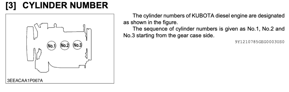

From the workshop manual of another Kubota engine:-
[3] CYLINDER NUMBER
The cylinder numbers of KUBOTA diesel engine are designated
as shown in the figure.
The sequence of cylinder numbers is given as No.1, No.2 and
No.3 starting from the gear case side.
Thanks my engine is 4 cylinder
I was wondering if number one is closest to the cranking spline and belt or the gearbox end of engine
