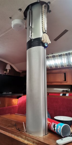

hi . On my comfortina 32, the mast makes a nasty sound like tack-tack-tack whenever it moves . any ideas how to silence it easily ? would grease help from above ? many thanks .

Is it wires inside the mast? If it is just creaking against the deck then a better pad here will help. We used thick rubber wedges. If wires you need to use conduit or attach cable ties at regular intervals with the tails sticking out

Many thanks everyone ! it turns out it's that table that the pringles are sitting on lol! I'm gonna drop it and put some duct tape around the mast so that there is something between wood and the aluminum .

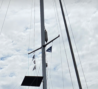

Our mast vibrates when certain wind speeds hit it sideways. Caused by vortex shedding.
Previous owner had a small strip of mainsail (about 10cm wide) that he hoisted up to prevent this. We figured out that hoisting a fender to about half mast height and having it tight against the mast works even better.
Gets a lot of questions in marinas, though.

unlike what I said before , it turns out it was the boom after all. oiled and greased the joints until it stopped . bliss !
