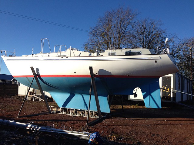

I researched cradles a couple of years ago for my Rival 41C. Apparently so called 'Marina Cradles' are all 8 legged based on a recommendation by an association, I cant remember which. The sales pitch was that the 8 leg cradles were more secure. Most of the companies I looked at also offered 6 leg cradles for the private consumer but again the sales pitch was that 'you are only allowed 8 leg cradles in marinas for HSE and insurance purposes'. I don't dismiss the sales pitch as out of hand because with lighter layups and small section keels, then an 8 leg cradle may offer the securest support for a marina that has to manage different designs.
Anyway, I ended up purchasing a second hand 4 leg cradle and she has sat through F10 on the beam and bow. The cradle is an old Yacht Leg's design where the weight of the yacht is taken on her keel, transferred into a base plate, and the 4 x arms support the hull on the sides (no hull props) from toppling over by triangulating any side force into the plate that the keel sits on. My Rival being 12 tonne with an encapsulated keel can easily sit on her own keel all day long. My mast and spray hood are down. I feel her moving in the gusts, like a slight elastic sway, very slight.
