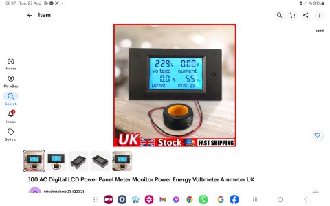

I use one of these. Lithium batteries. 3kw inverter and induction hob. Seems to work fine and reads the low output of the pulsing induction hob on power settings below 1000w
