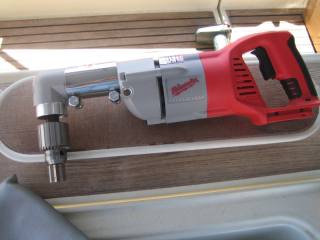

18v tools are typically not strong enough. The right tool for the job is "Milwaukee 28v right angled drill" with a winch bit (winchbit.com)
here it is in action

I bought one - it works on my 43 with an extra heavy (charter use) mainsail. I sail effectively singlehanded when with SWMBO. I need to wake her 2 hrs outside Cherbourg so that she can shower etc. She is wonderful with mooring ropes!!
This Unfortunately is/was not available in UK. I imported mine from USA. When I investigated the Milwalkee had a torque of 600lbins and the nearest equivalent was a DeWalt at 320lbins IIRC - not sure whether any competitors have bought out versions with comparable torque in last few years.
