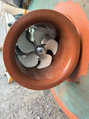

Any reason for CC-ing the stern and not the bow thruster, folks?
In my boat, I've got velox plus for main props and rudders, but CC on both thrusters, and I never had any issue.
Both plastic props for the records, as opposed to nibral for propulsion.
Simplistically the stern thruster tube sits proud of the transom, and thus is coppercoated inside the tube and outside. The bowtruster tube is internal within the bow, and is coppercoated internally. Both propellers are plastic, hence no treatment.
