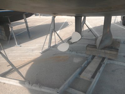

Definitely not AMC specifically say do not use it on saildrive legs, primarily because to achieve the desired thickness will restrict the water intake slots. I have had 2 saildrives, the second with Coppercoated hull and have found the spray on International Prop -O- Drev or Hempel Ecopower very effective. Not so good on propellers because it erodes quickly and Velox is best here. You can also use Velox on tthe leg if it has only the original epoxy on it, but difficult to remove other coatings to get back to the original.
This is my Bavaria 33 with Hempel on the drive and prop hub and Velox on the blades.
