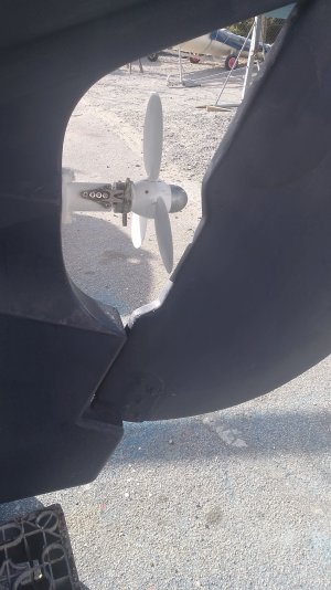

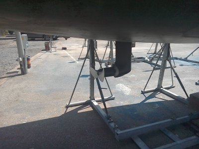

Velox as described in the linked thread is one approach, but it requires very careful preparation and may not last more than 2 or 3 years. Prep is difficult on the saildrive housing as ideally you should get back to bare metal, but that means removing the factory coating and not sure that is a good idea. The metal primer (either Hammerite or Velox) may well stick to the existing coating but i have not tried. On my Coppercoated Bavaria I used the normal Hempel Ecopower spray primer and top coat and this was reasonable lasting a year with just a few barnacles. Props are a different problem depending on what prop you have. If a standard Volvo aluminium, similar issues to the drive housing except that adhesion of Ecopower is poor on the blades and adhesion of Velox may be difficult. Easier if you have a folding or feathering prop as it is easier to apply Velox to bronze. I did the blades in Velox and the hub in Ecopower on my Bavaria as the hub seemed to suffer less from fouling than the blades. On my current boat with a feathering prop adhesion was poor with Ecopower so this year I bit the bullet and went Velox.
I aim for once a year wash, but with a saildrive you also have to think about anode changes. Our club does not allow any painting while in the strops and Ecopower really needs a top up to go another year. Photos show my Bavaria and my current Velox coated prop.
