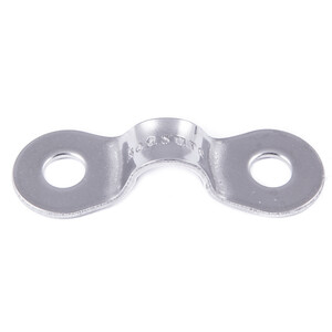

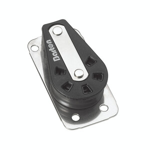

Ditto, except I bought the bits and did it myself.
and
on each side of the boom and a block at the gooseneck, up through the cringle and back down to a cleat. Repeat for the other reef.
Worth thinking about bringing the lines aft, as it's really nice not to have to go forward to put a second reef in on a small boat, but that starts to get expensive unless you can find second hand bits.
