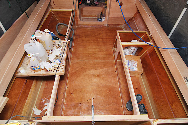

Going well, thanks. Drilled/cut 33 holes in it yesterday, for routing steering cables (ordered wrong size, aargh!), mounting cleats etc. Spent most of the day sanding. Aching today.
No new pic's 'cos the builders' forum won't allow me to upload any more, but they are trying to resolve it for me. In the meantime, I have others hiding on another server.
Here's one...
