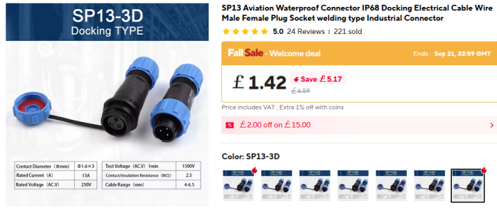

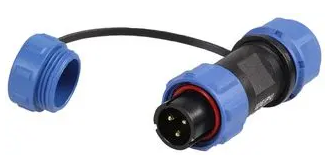

Agree it is smaller but for an inline connection you would have to solder on to the pcb header and unless you have a handed row of pins they could be connected the wrong way round. I would prefer some strain relief and waterproofing on any boat connection.
If you don't mind waiting you can get them for silly money from Ali Express
