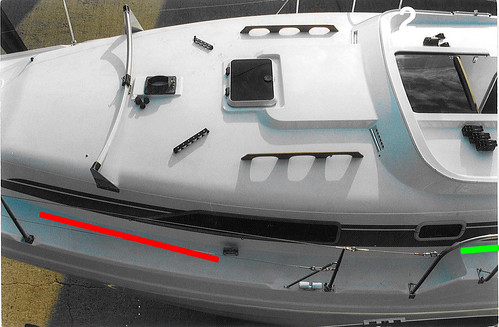

I am looking to replace my Lofrans manual windless with a standard mooring cleat.
I would also like to have two smaller mooring cleats on the toerail on the bow........but I already have two fairleads in these positions which to be honest are also useful.
So, what I need is a combined mooring cleat which also has a fairlead...........
Does anyone know if such an item exists, and if so, where can I get them?

I will have one central cleat on the bow, which I will use when anchoring etc. and when tying up to my swinging mooring....with the two lines running through the existing bow fairleads.
However, I would also like two smaller mooring cleats for when tying up to pontoons etc.
I haven't got room for both, so if I can find a combined version I would be very happy.

Thanks misterg, that's the type of cleat I'm looking for..............just got to try and find someone who still makes / sells them.
Thanks too Rogershaw, that type of cleat / bollard would do the job, are they custom made? If I can't find anything 'off the shelf' I'll have to get something made, and that has given me some idea's. I would need to scale it down somewhat to fit my bow though /forums/images/graemlins/grin.gif
I've 'doodled' this in my CAD system.......this type of thing would be ideal:
