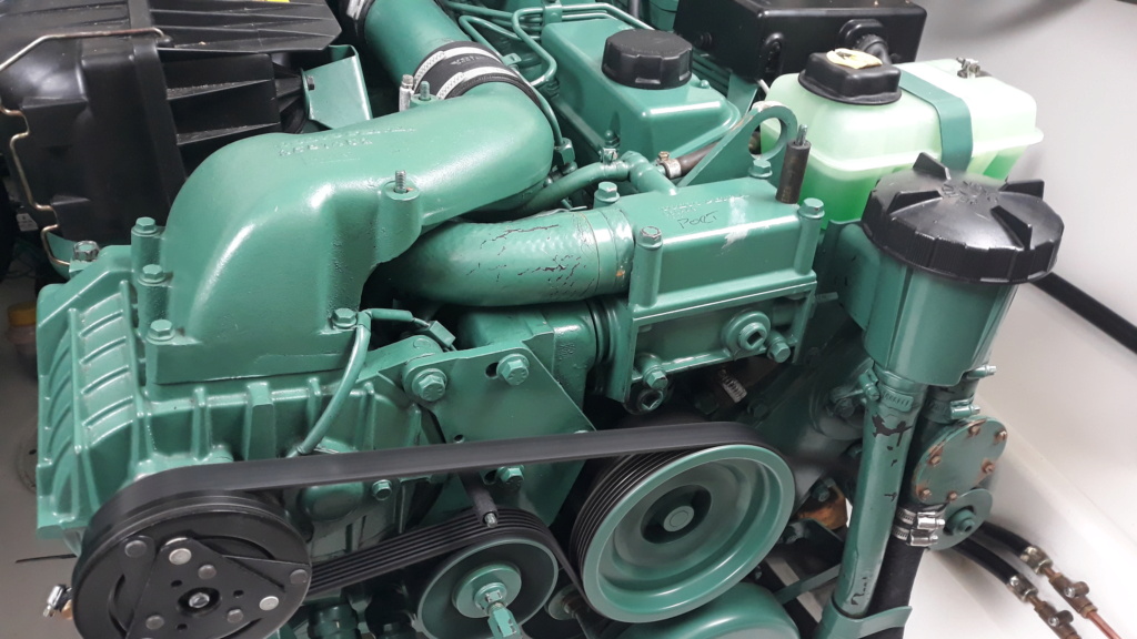

The coolant level shown in the image below may prove to be too high (I later drained some off).........
@ Martyn , you always put us to shame with your almost immaculate ER pics .
Winters coming on .
The red circles are corrosion and the blue line highlights probably the trickiest thing to detail cracked paint on rubber flexing pipes .
A a National concourse ( if such a thing were ever to exist in the VP world ) you would drop points so 95/100
That might not be enough to carry off the trophy fwiw :)
Winters coming on .
Its not bad for a 17 year old boat .
Will check out the corrosion bottom right as had not noticed that.
No way I will be painting hoses .:)
