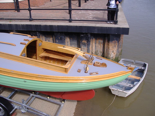

I use the RWO model R0500, pictured here RWO Fittings . For extension diameter 19mm. My tiller and extension are both wooden. Very sturdy matt finish stainless steel, looks and works a treat I think. Obtainable from Western Marine in Ireland for less than £20 as I recall. Never found a UK dealer.
Here it is on my boat:
http://www.flickr.com/photo_zoom.gne?id=185875693&size=m&context=set-72157594193298822
For a close-up, select 'Original' to the top-right of the photo, and scroll around a bit!
Many thanks. That's the sort of thing I was looking for. It looks larger than the Compass one. I see you have not laminated either, so I think I wont as I prefer the solid wood look. Lovely yacht btw!
