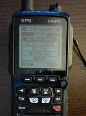

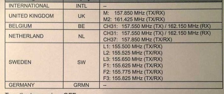

You should find a radio which supports specific regional settings, most are US-CAN-INT but some have other ones for example ''UK''. Ch37 is also on the NL frequency plan (though they have a lot more limitations/prohibitions).
This is for my Standard horizon HX870, it can be chosen by pushing some sort of button combinations before powering up. I have a very old SH HX260 which has natively M and M2.

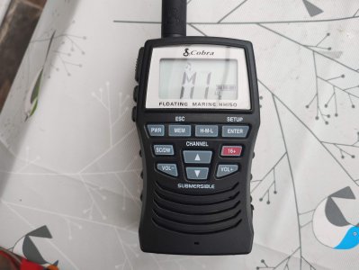

I'll answer my own question with the Cobra 150 for £65. Why the cheap model has M1 but it's more expensive brother does not is a mystery but there you go.
To answer why it has to be cheap, well it gets used for afew minutes each year so why pay more.
