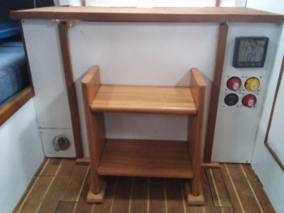

That does sound odd. The simple way of getting charge from the alternator is to use a charge splitter such as a VSR between the start battery and the house bank. I used one of these. force4.co.uk/item/BEP/Dual-Battery-Single-Engine-DVSR-Cluster/94Z
Simple to wire up, gives independent switching for each bank and the ability to parallel so that you can use the house bank in an emergency to start the engine. The photo shows what it looks like in my boat.

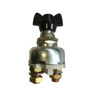

My starter battery has two , live and neutral , key switches directly wired using normal battery heavy cable that must be switched on to start the engine via the start button.
Not answering your question (Tranona has dealt with that) but I think 2 battery isolator switches is unnecessary. You could reasonably and safely get rid of the negative side switch and put it to some other use.
Thank you Tranona. Looks great but a bit more than I wanted to spend for issue thatc occured once in 10 years . I did buy one of the 1, 2 both and off that worked great on my old Centar but haven't decided if it's the answer.
I used mine (another Scandinavian boat) to make an emergency domestic to engine connection.
Thanks , That's something along the lines I'm tthinking off. The selection switch, 1,2 both and off, I had on the old Westerly seemed to work well and if memory serves did the job without much in the way of electronics. Maybe that could be a way forward.
The really cheap option is what I had on my previous boat: All the negatives connected to the engine block; A 0-1-2-B switch, common to the starter, 1 to the engine battery, 2 to domestics, and a simple cube relay operated from the field coil (charge warning light) connection on the alternator. A VSR would be better, but the cube relay would be change from a fiver.
Off isolates the engine battery, 1 for normal use, 2 to start from the domestic, both to parallel the two, which I never had to use, but would allow charging the domestics if the relay fails.
