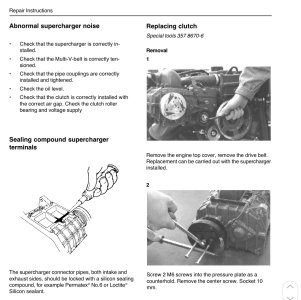

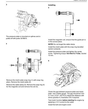

Hello gents !
I,m about to change the tensioner pulley of the compressor belt on my kad44 , thought it is as simple as it gets but i,m confused .
How do i remove the pulley from the tensioner assembly ?
Thanks for any help
