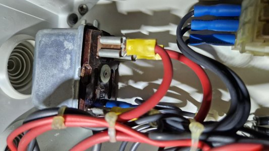

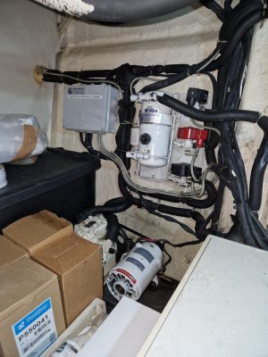

Hi, I have 3 fridges on the boat. The FB fridge is 24v only and has its own compressor. The galley fridge freezer has 24v and 240v and the saloon fridge is 24v. Both the saloon fridge and the 24v part of the galley are cooled by a central Frigomar compressor etc in the engine room. Yesterday after returning from a trip I noticed that the 24v system was not working, nothing had tripped. I twiddled the thermostat and nothing. The compressor was not running. However when switching on the breaker it seemed to be drawing 3amps. A little later I tried again and it worked, but I did notice a lot of fluctuation in current draw. The 3 solenoid coils are working. The next part was to look in the wiring panel in the engine room. I think the culprit may be what I assume is a relay, the internal gubbins seems loose and no longer held captive by the aluminum case. I'm not great with electrics so would really appreciate any input as to whether this is a likely cause. I didn't delve any further as I'm not 100% sure that there are no 240v circuits running into this panel.

cannot really help as i've never seen a remotely controlled fridge system, but the above pic is a simple relay, 99.9% 24VDC (could be a 12 or even 6V primary coil in there) and can be bought from any auto/electrician shop for a few euros, worth getting a couple. Just check the rating, doubt its going to be more than 15A.
Also most likely the loose bits is the metal shield itself, if not, you definitely replace it and you should be good to go!

Thanks VAS, I took the relay out yesterday - it's 24v and 50A with 4 connectors
50A??? blimey, do the cables support that 50?
EDIT: rhetorical Q, definitely not!
maybe that's why it has this metal shield on it.
Did you open it? (relatively easy to do without breaking the plastic lid if you're careful) Mind I'd just replace that and keep the one in my spares box if it behaves!
Vas, if you enlarge the pic showing the compressor, you'll see on the motor label that its absorption is 14A.
I guess the relais was either already replaced or just used with a higher capacity because that's what they had on hand upon boat assembly.

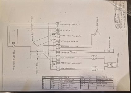

Hey P, the breaker on the panel is indeed less, 16a. The relay is OEM, I have found the wiring diagram
Fair enough. It surely doesn't hurt if the relay is rated for much more than he will ever handle, considering that above 16A the breaker woud trip.
Interestingly, I see no mention of AC supply - according to the diagram, everything seems to be feeded by 24VDC.

I'm resurrecting this thread as despite the fridges having behaved themselves for a year, the problem is back, just in time to coincide with the summer! All was working fine for about 5 days then it stopped. I have swapped out the relay, and it's not that. There is power to the relay and the coils, but not to the motor. I am assuming that something is preventing the relay from switching. Logically, as there are 2 fridges, each with a thermostat, I can't imagine that both failed at the same time. That leaves 3 things as per the wiring diagram, items 13 to 18 which seem to be a frost sensor, valve / coil for defrost and a defrost timer. I'm assuming these are automatic defrost functions because there's no obvious way to control these. I would appreciate any tips on either testing these - not sure if I should jump them, disconnect, which one first etc...20230820_145852.jpg
I would put a meter on them to confirm they are on / off as opposed to resistance
If on / off then I would either short them if off or disconnect if on and see what happens.
Worst case you can hard wire the pump via the thermostat which as long as it is able to switch the current would be fine. If it can't then you can wire the thermostat to trigger the relay by removing it and doing a hack wiring job.
Thanks Jeremy. I tried all of the above... a good learning experience as I'm not super confident with electrics, but to no avail. I didn't give up and decided to start testing again from scratch. I think I must have originally taken my reading for zero power to the motor from the wrong place, because this time it was showing power. I though I'd inspect the brushes, and hey presto, one had completely worn out. Replaced both brushes and all works again. Glad I had spares on board!
