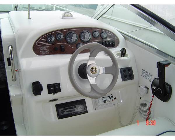

CE marking is usually in a fairly prominent place (e.g. on a plate just below the throttle on my US imported boat). But if your Fletcher is pre June '98 then the RCD doesn't apply (?) and I don't suppose it will be marked anyway.
(Edit: well, when I say "just below" the throttle, what I really mean is "just in in front of". Here's a photo of a sister ship (a slightly earlier model than mine), clearly showing the CE marking plate.)
