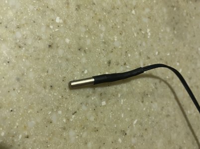

It works extremely well but as I’ve posted in PBO a wire on the thermistor is broken. I’ve just been in a marine store in Sint Maarten where they offered me a whole new unit.

Thanks Yoda; that’s really kind. Unfortunately we’re in Sint Maarten atm and going to lay up in St Kitts (keel in a trench) so nowhere near Grenada. I’ll see if Doug (RumPirate) can get Amazon deliveries. Otherwise I’ll epoxy over the solder joint to provide mechanical support and heatshrink sleeve over that. It’ll hopefully survive like that until we come out again next winter. In the meantime I’ll climb in the cockpit locker and get the multimeter on the connection to the thermistor and try and work out which one it is.

In the meantime, I’ve re soldered it and then encapsulated in epoxy plus put a heatshrink sleeve over it. Hopefully it’ll hold together until I fly out with a new one next season.
Here’s my repair.
I’ve measured the resistance and it was approximately 22k ohms at the temperature it was at so I’m assuming a 20 k nominal resistance thermistor will be a replacement.

Just got to work out if I will need to recalibrate the electronics box for what isn’t an OE thermistor… There’s bound to be a calibration pot in there somewhere.
