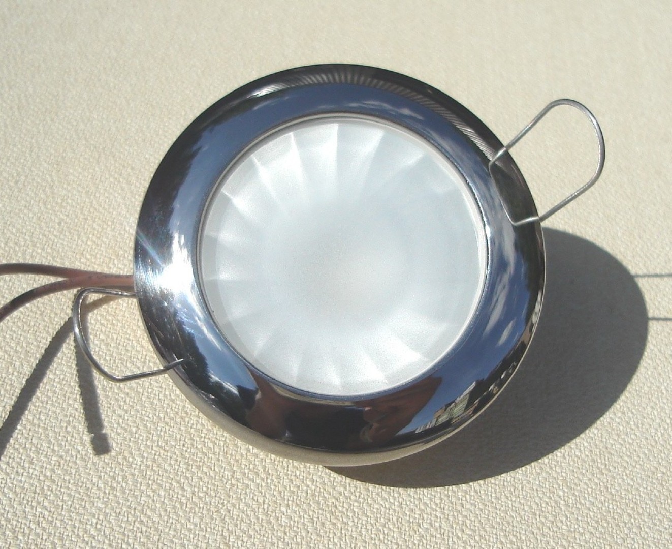

At some point I will change my existing halogen bulbs over to LED's and suspect I'll break a few of the fittings in the process. Having one or two spares would be useful anyway.
So does anyone have any spares that they'd be willing to part with?

Probably easier to make up some alternative spring fittings
I bought some fittings the same size from coastal rides which went in the master and then freed up a supply that i could use to fix the broken ones.
I dont think you can make up new springs.
The springs slot into some very very soft metal lugs that break. I would guess that they break after 3-4 removals - which is not a lot of lightbulb changes. There is no obvious was of replacing these lugs.
Poor design.
Alterative is silicone - but then you cant get them out again!

I too have purchased replacements through ImpProducts. Agree poor design as the internal btass or whatever becomes brittle and the lugs hding the springs bteak off. Bit expensive so option 1 - saw into the side of the hole so as to create new lugs... just a few mm... to hold the springs; option 2 - fix a metal strip inside to hold the brass tube together and replace the lugs for holding the springs.

IMP products have lots of Madrids (the small fittings used in bathrooms, etc) and sell them for £10 each.
IMP products have LED fittings that look virtually identical to Dallas ones.
So my recommendation would be to change all the fittings in say one cabin for the IMP (improducts.co.uk) ones then use the spare Dallas ones that are freed up elsewhere.

I've swapped most of my boat over to led bulbs but 3 fittings broke in the cockpit while removing, luckily they are a tight fit and one spring is holding them at the moment.
