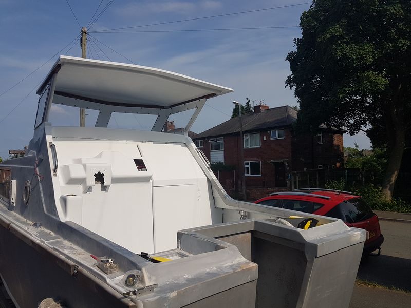

I am in the design of the canopy frame for this boat and as i have a 19mm 3/4" bender i was going with that. Now as i am finding it difficult to find fittings for it, mainly a couple of tube hinges, i am thinking is it to small a tube for this size canopy?
If it is a bit on the small size i can always get pre bent tube and weld them in as i only need two 90 degree bends at the minute. Just rather not.

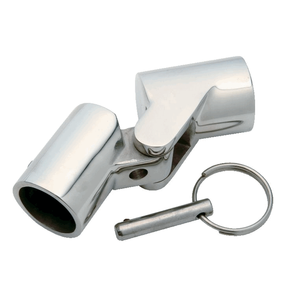

Hi there
Am i being lazy you think lol Not looked at S3i yet. will go mooch now.
Its these i am after but more i think 22/25mm will be better than 19mm now fro the sake of a bit more effort.
Just buggin me as i am sure that a member on here sent me a link a while ago for these in 19mm but after afew hours looking i cant find any.
