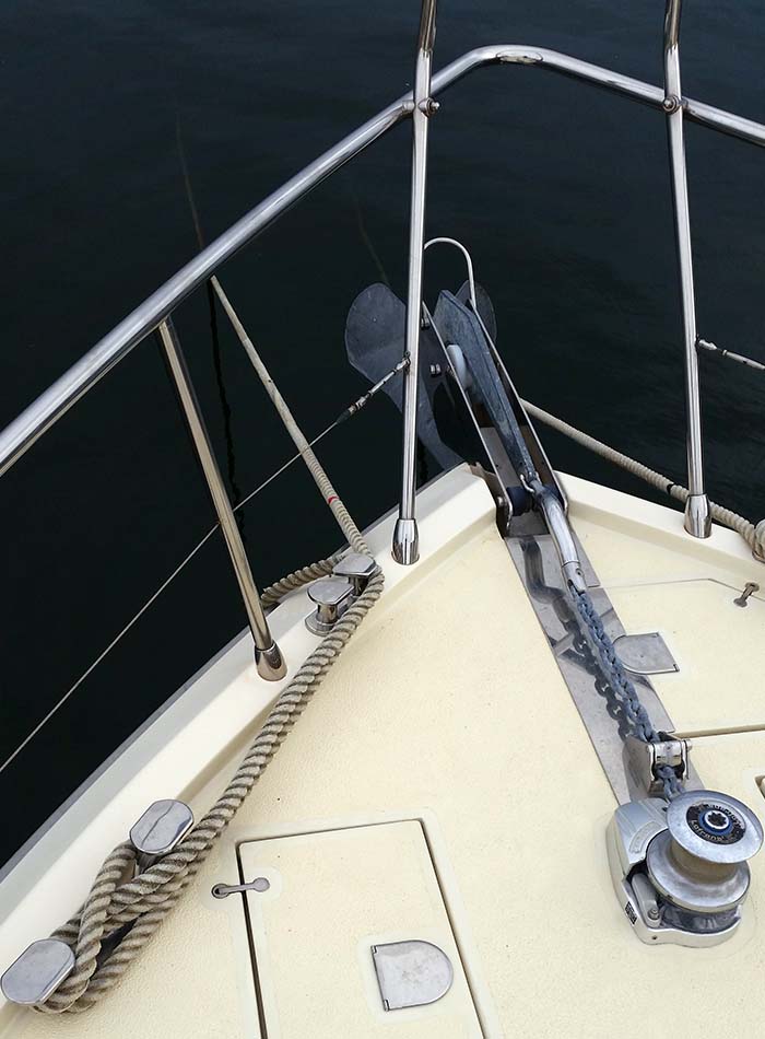

Nope, the idea is to either replace the existing fairleads or add a second couple closer to the cleat, straight before the stanchions rather than after it, as they are in current setup (see below).
The problem of existing fairleads is that the opening in them is only good for up to 24mm or so lines, which is OK in most places, but when the bow lines are larger, as in the following pic, it's impossible to pass them inside the fairleads.
But as you can see, even if the existing fairleads are rather small in comparison with the cleats (which are about 15" long, just as a reference), they are actually ok, aside from the tight line passage.
Haha, nothing like saying that the reasons are irrelevant, in order to raise questions like this, I reckon! :D
Can I see two cable ties (Red and Green) to show you how far to pull the lines in?
The purpose is precisely that, but cable ties they aren't - just vinyl electrical tape.
The trick for making it last and stay attached well, aside obviously from waiting for the line to be bone dry, is to pull it well while going round the line. Good enough for a whole season, in my experience. :encouragement:
