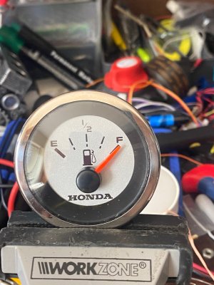

Busy with a Honda fuel gauge.
Purple Velvet
6 Mar 2026
150

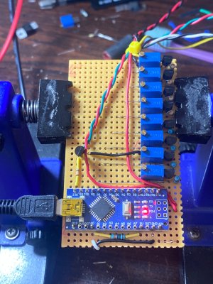

This Honda fuel gauge and the sender which fits the tank are incompatible (inverted). I am currently having a break from building modules and decided to build a controller for it incorporating a low fuel waning light. All seems to work, although I cocked up building it right to the edges of the board and so it won't fit in the case I printed for it now! Oh well.
A bit more testing and then it can be called a done job.
