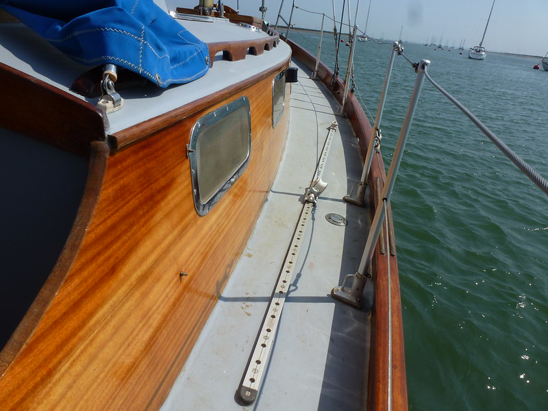

Sorry if you think you have been misunderstood, but it was not an unreasonable assumption to make from your question and the length of band you want.
However I answered your question. Yes you can edge bend it but not very much. So if you are putting it on the top of the toe rail you will not get much bend before it kinks. If you are putting it on the vertical surface then it will bend very easily and you can follow the curve of the hull.
As you see from tillergirl's photos it is common to use short lengths in strategic places. If you want to use brass that is what you have to do because of the limitations of the material you are using.
Suggest you make up your strips doing all the cutting and bending before you drill and countersink the holes for screws.
